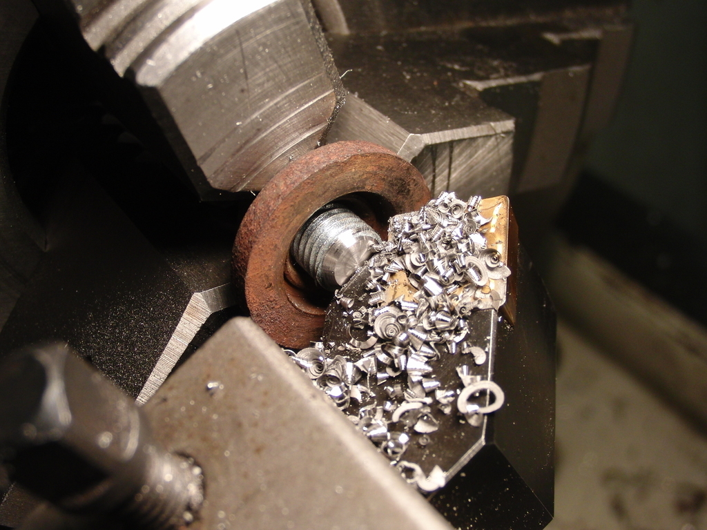

- Individually removed between 1.5 and 6.5 mm from the new manifold studs (on a lathe) so they're just as long as need be on the outside and as long as the thread goes into the cylinder head. Now there's no trouble getting on those nuts and all the thread is used. Then fitted all studs with industrial nickel paste "Chesterton 725". Awesome stuff I hadn't known until these days.

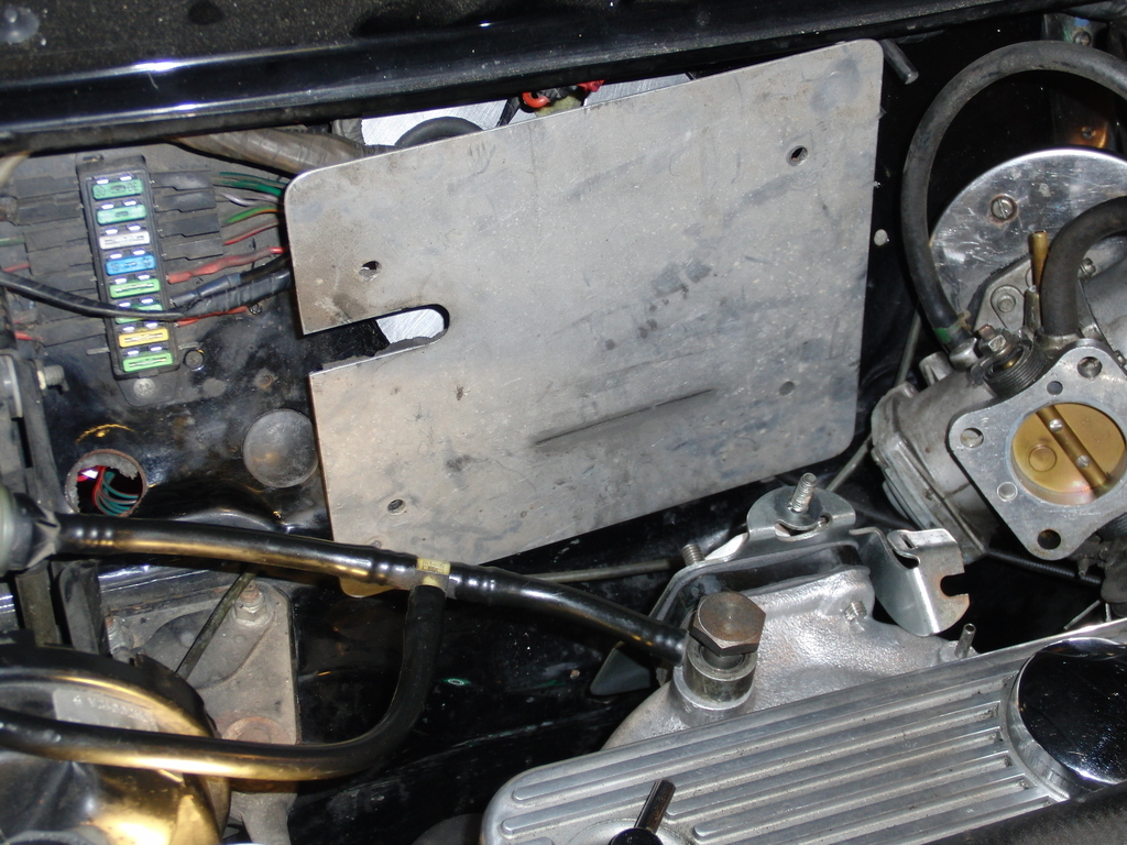

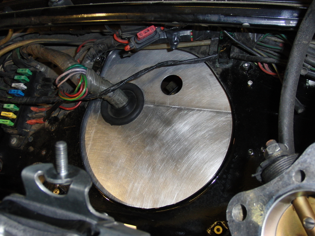

- Drew up and fabricated a (two-part) closing plate for the huge hole between engine and passenger compartment. The old one (made by pre-owner) was fitted on the engine side, not leaving enough room for the air filter (see groove from scrubbing) and not sealing in various places (=engine smell on the inside).
The newly created plates are recessed (milled away ~0.75 mm of 1.5 mm sheet) at their mating edge, so they overlap and seal nicely. Also used the original welded-on nuts, albeit just to stick through some M4 screws. Also, the grommet around the cables is of use now.
Once again: Why can't this part be bought?! There must be thousands of odd self-made creations for that hole.
