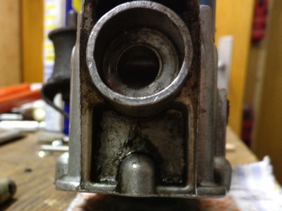

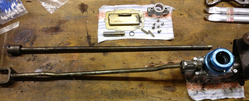

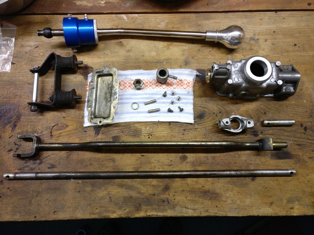

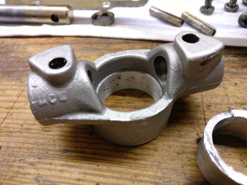

I couldn't get the quickshift off of the gearlever housing, so I took it out of the car. Before opening, I gave it a quick clean (with WD40, my handy dentist tool and some rags).

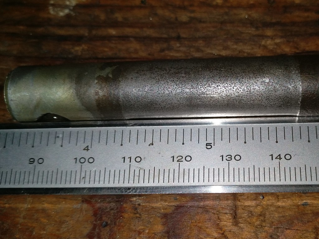

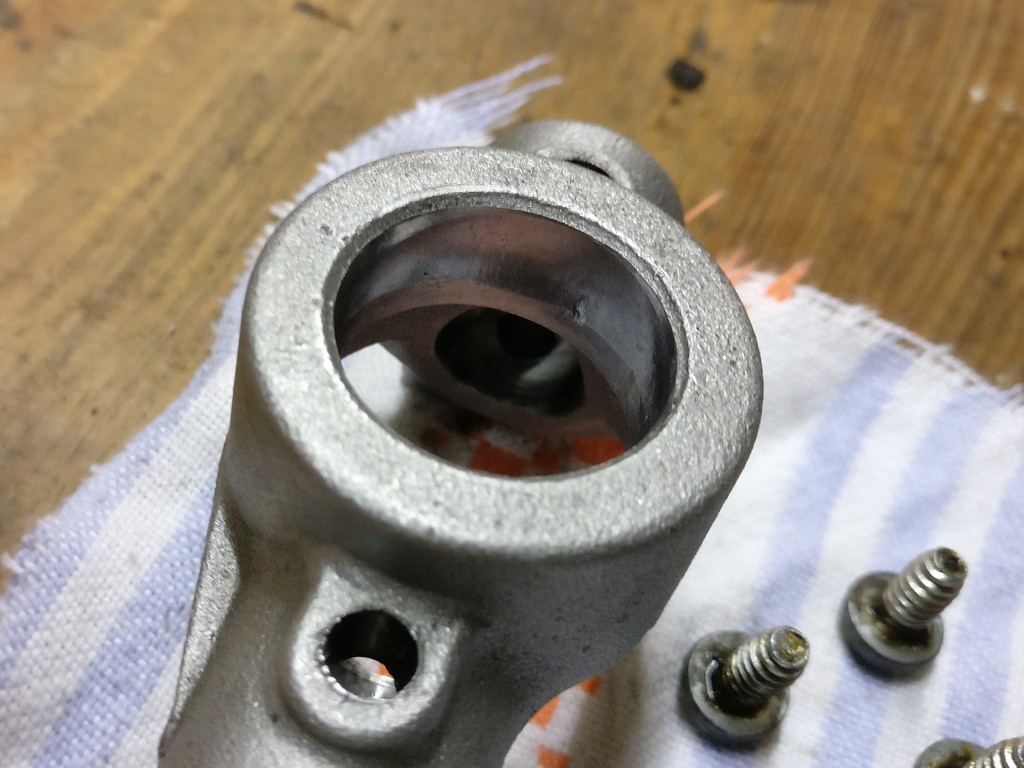

While disassembling, the wear showed:
And the worst, which gives it lots of play:
I'll probably turn that out on the lathe and make a bush out of bearing bronze. Also a longer bronze bushing for the gear change rod above that has a wider contact area.
The ball at the end of the gear lever of the new quickshift is made from some kind of plastic, so I guess some day it will have to be replaced. The old one was made of steel (I think), which wore out the "gear lever extension rod eye" (I had to look that up).

That's actually a good idea, never heard of it. Yes, I also just realized the rod is 1/2 inch. I briefly thought about making a new one, but I don't have the right stock and also, it can be turned around, so the worn area is switched to where it doesn't matter. That's pretty cool.
Now I only need to figure out how to make 12.6 mm inner diameter on the lathe... and I need bronze.

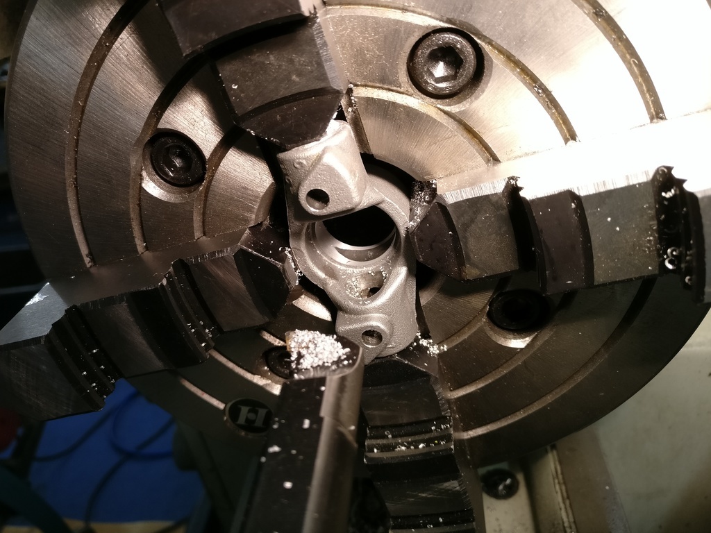

I removed from the eye what was worn out (clearly to be seen) using the 4-jaw chuck:
Great quality aluminium, with steel bushing to the right:

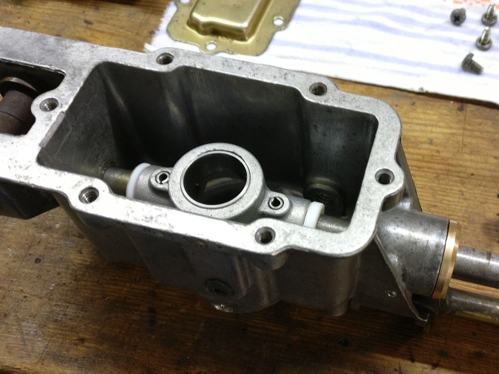

I pressed in the steel sleeve, re-dialed in the piece on the lathe and turned the inner diameter to 22.2 mm, so the plastic end ball fits very snugly:
I'm happy with the result and since the ball is plastic (I hope PTFE), steel is a fine partner (instead of bronze).

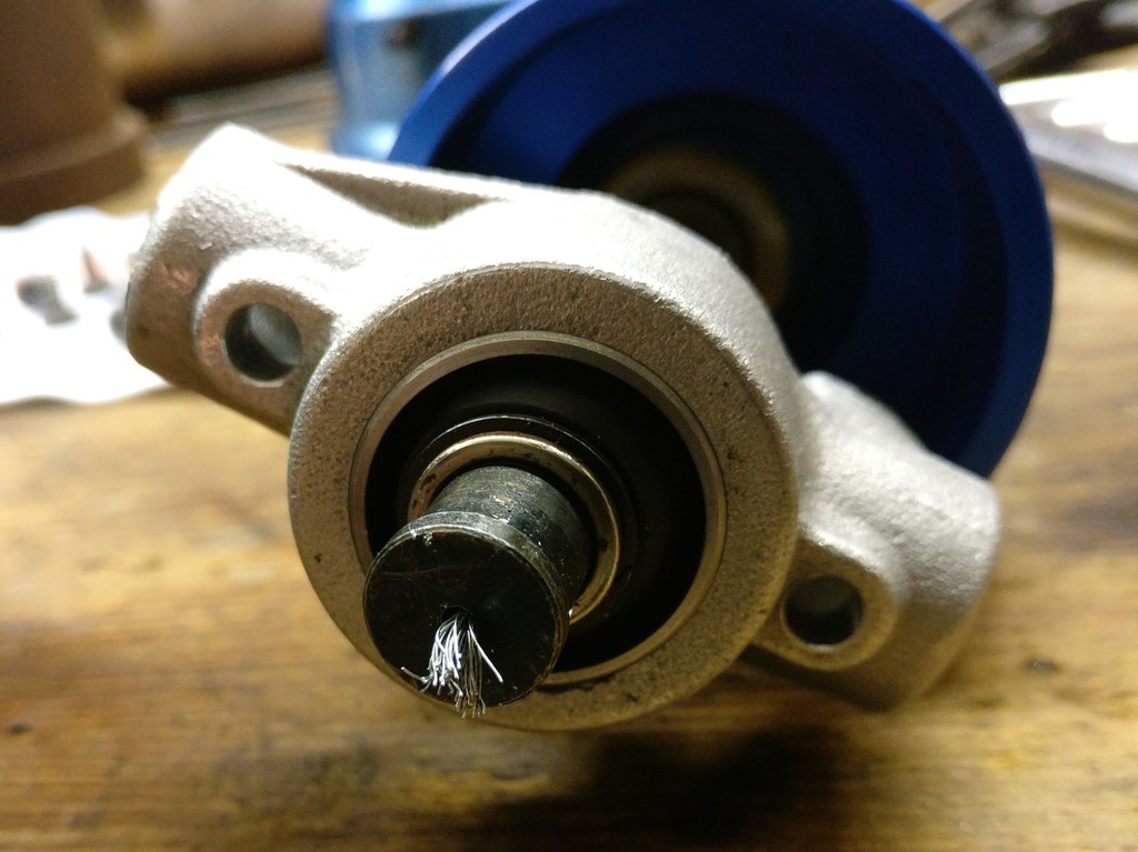

I wonder why they kept the cable strands on there. Will need to cut those very closely.

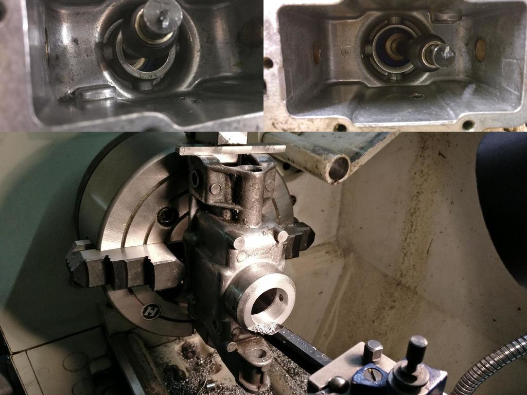

- Realized the lever was hitting the casing on the inside. Milled away 3 mm inside, then put the casing in the 4-jaw-chuck and turned away more. The lever moves freely everywhere now, which I guess, is what's intended.
- Ground down the cable strands at the end of the lever (with something akin to a Dremel tool).

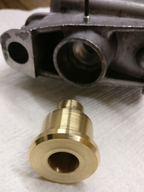

- Got some bearing bronze, made a new very long bushing for the rod. Looks nice too (look at the left side of the casing).

"Volvo 850 shifter housing that could be retrofitted into anything... Such as a boat with a van gearbox,or a mini van" ;-)
Cables were beefy, too. Over engineered to hell :-D

Wow that's a beefy shifter housing! You can clearly see the difference in swedish and british engineering mentality. :D

My shifter housing is now complete again, with no play and smooth movements. I'm so keen on test driving this. :) Still waiting for the tie rods, I guess they ran out of ore or something... unfortunately, the boot for the gear change rod should come with the same order.
The bronze bushing with added M4 set screw:
Completed with everything, including new teflon spacers:
This is where the gear lever was hitting the inside of the casing and how shows how useful a 4-jaw-chuck can be:

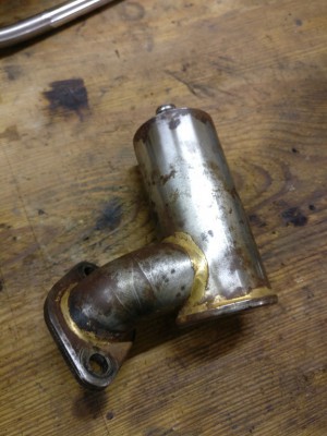

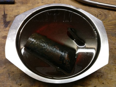

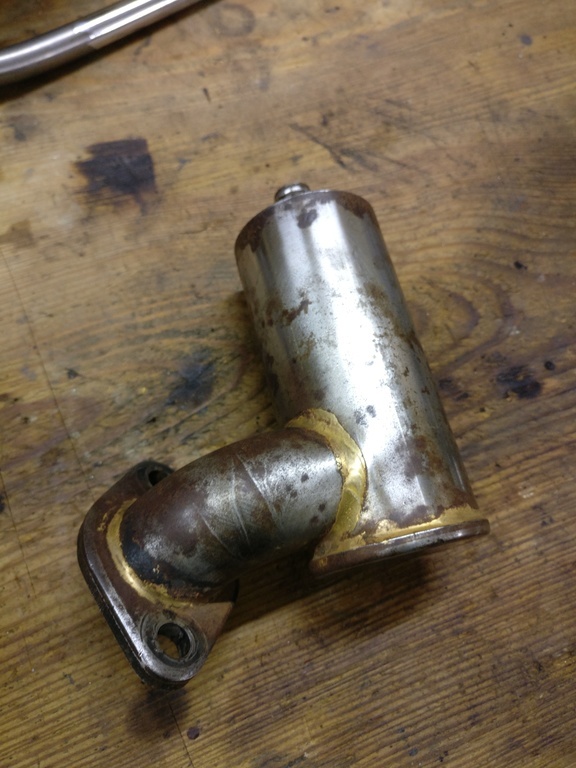

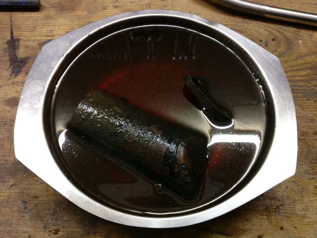

Reminded by Freds crankcase pressure escapades, I checked the one crankcase breather that's easily removed. Sure enough, plugged. A tablespoon worth of grease-like gunk could be scraped out by hand and now it's soaking in lye over night:

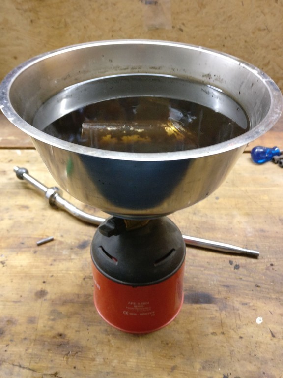

The breather is clean again, after I upped my game:
The hot lye removed almost everything (including the paint), except a little greasy residue in the steel wool that's inside. Then I remembered what I use to wash out bearings: Petroleum. A sip of petroleum, a good shake and I think it's good as new now. Should've done that as first step, then the lye, but oh well... Anyways, that's what the part looked like afterwards (a thing of beauty!):

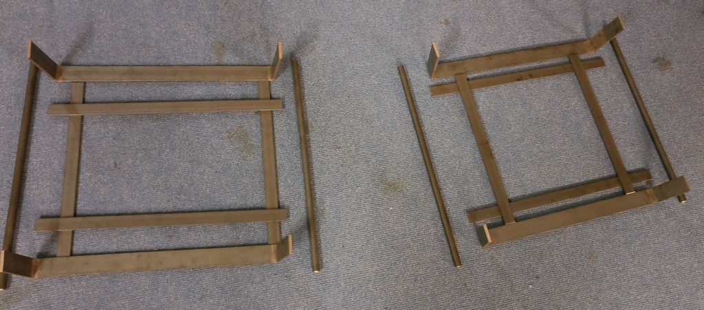

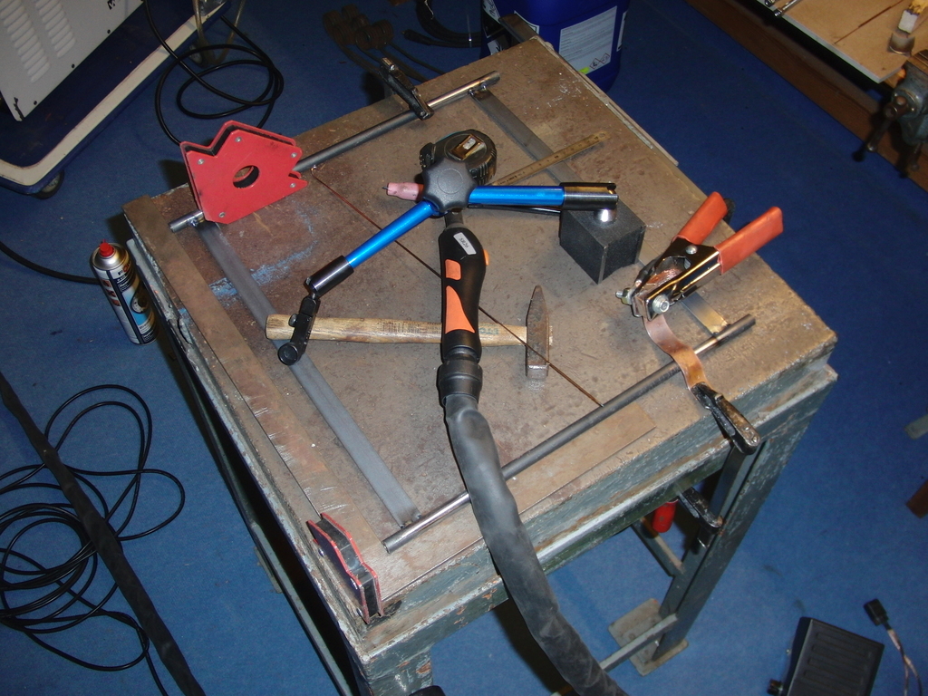

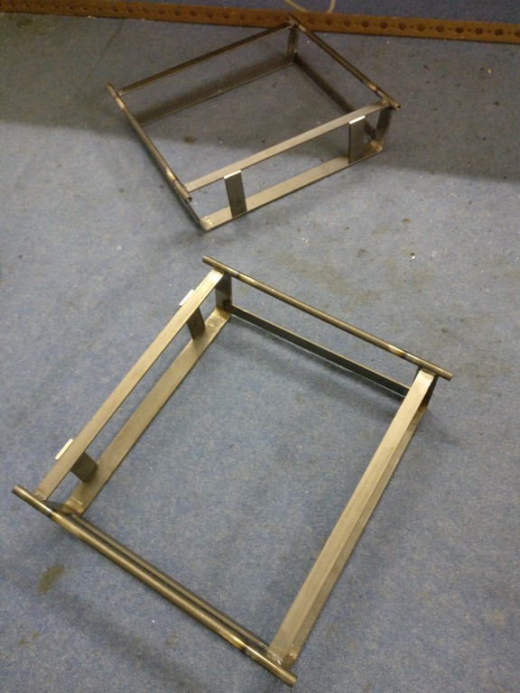

Then there are the seat rails, which started out on the table like this:
It looks like a mess, but it was crucial things line up. There's something I learned today: When tack-welding, don't put the points where I did. The hot spot will cool and contract, messing up the geometry. At the second set, I tacked at the center of the flat steel braces, which had much less of an impact.

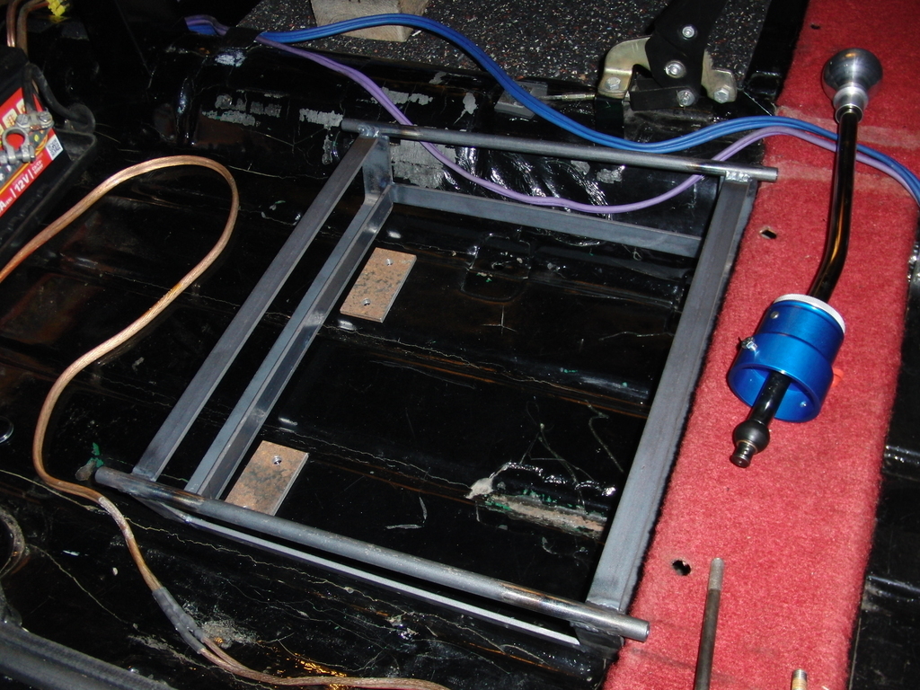

This is the status right now, test fit in the car and with the backing plates that go beneath the car:
Both of them with the front mount plates:
In case you're wondering: Yes, the round bars are angled at 3°. And yes, they're pretty heavy, unfortunately. But they sure will make a great ride. :)
Tomorrow will be finishing all the welds and maybe even fitting them to the car.
