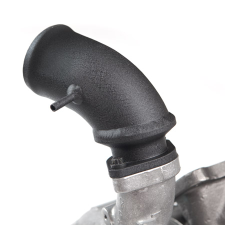

Would you say that these two examples are roughly what you're suggesting? Both are amazingly unique in the Evo world for some reason.Fred wrote:The flat bolt-on location is a good place to bolt a perfectly port-matched tapered piece out to your 2.5" silicone coupler
I personally would NOT use the OEM downpipe/exhaust...fab your own up with v-band output, no O2, and better wg re-entry
