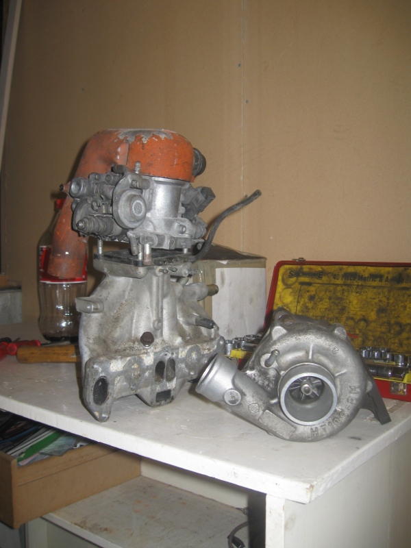

Finally got a pic of the intake lol
The t/b doesn't mount quite right as it is off a 13b and I am looking at getting some adaptors cut up for it, but you get the idea

OK, so regarding the MAP sensor. There are a couple of ~2mm holes just after the t/b linking one of the secondary runners and the primary runners - guess I'll run the map sensor off them.
