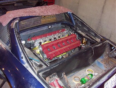

My current project is an 84 Ferrari 308. I’ve had the car 9 years now. The first thing I did when I got it was spend a year to rebuild the engine and design and install a supercharger system using a custom intake and an eaton MP90 blower. I installed a haltech E6k running multipoint injection with waste spark and it was good. It make 300 rwhp from the little 3.0 liter V8 and I drove it that way for a couple years.
After a couple years I decided if a small supercharger was good a bigger supercharger would be better so off with the MP90 and on with a whipple Ax2300 screw type blower with a new custom intake designed to hold a water/air intercooler. Off with the E6k and on with an E11V1. This setup made 420 rwhp at 22 psi on pump gas. The haltech just never quite delivered the control I was looking for so I upgraded to a motec M800 and things were good.
Fast forward a couple more years to the current project. I pulled the V8 out and bought myself a very tired 4.8L V12 from a Ferrari 400i. Then I got a set of 4 valve heads from a Testarossa saying “I’ll bet they fit†on the 400 block (which is a 2V engine). I’ve spent the past year and a half force fitting the 400 block onto the 308 transaxle and the TR heads onto the 400 block….it turned out this was a very bad idea and a just plain stupid amount of work but I’m getting there. If you are interesting in all the gory details I’ve got losts of pictures in a VERY long thread on the Ferrari forum, (they make you register to see the pics but its free and they don’t send spam). It should make about 750-800 crank hp at about 9000 rpm when complete
