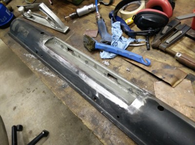

Lots has been done to this car this year.
The rear end had rust on the corners, as did the rear bumpers. Because the bumpers were bolted directly to the body without any kind of compression possibility, the corners of the car were dented in (?) and I never liked the flat plate where the license plate sat. Sooo basically for all the 15 years I've had this car, I had in mind to thoroughly clean the rear end. I've done that now and it looks awesome.

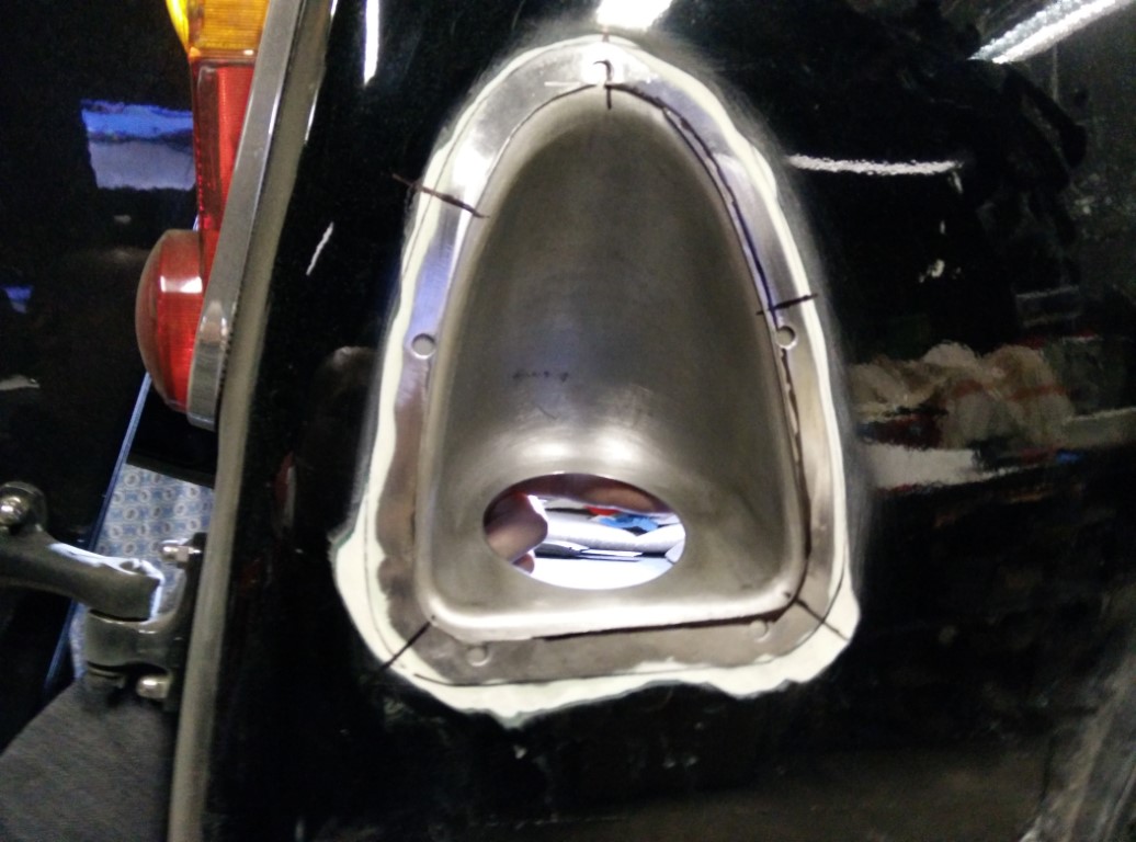

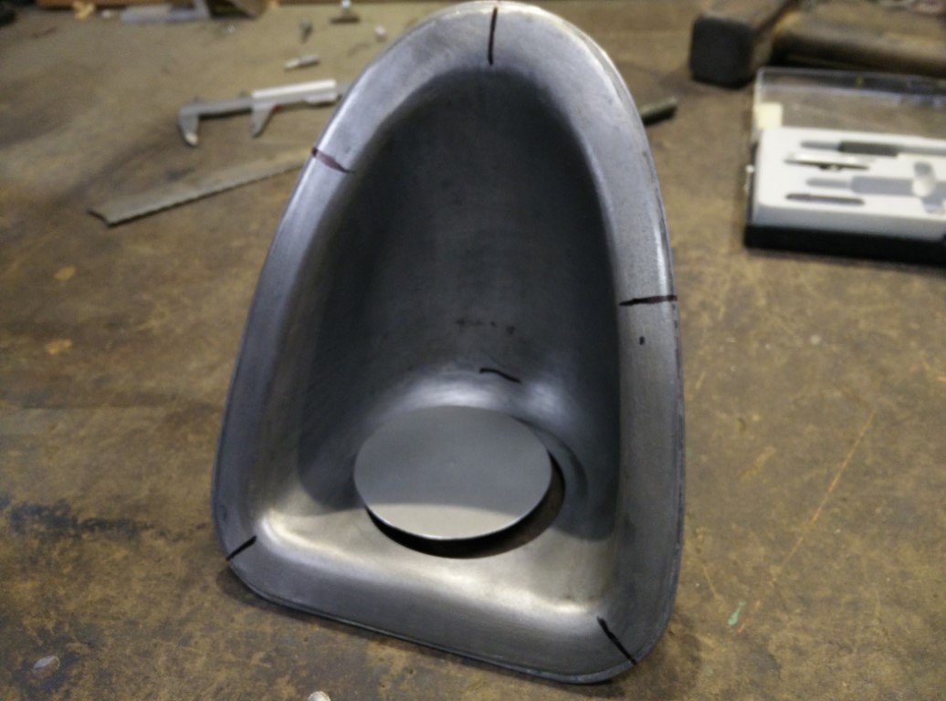

Since that piece where fuel tank filler pipe comes out was powdercoated and looked really bad, I also removed that and welded it to the inside of the side panel. Makes for a much cleaner look.

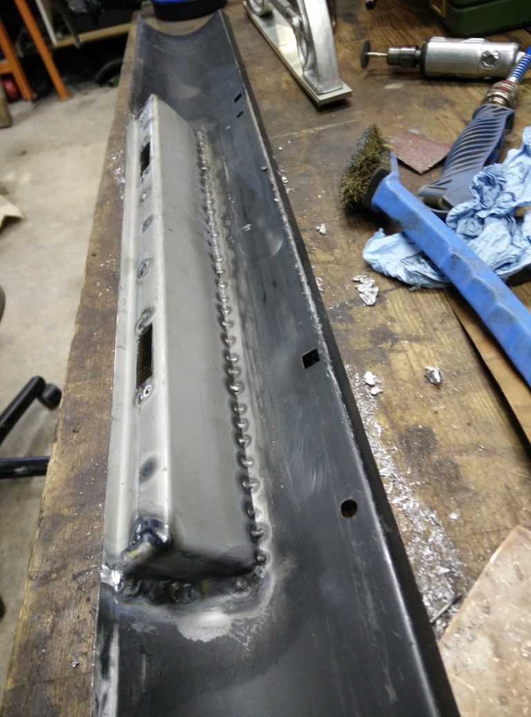

Folded some sheet metal to add a sunk-in place for the license plate. Finally.

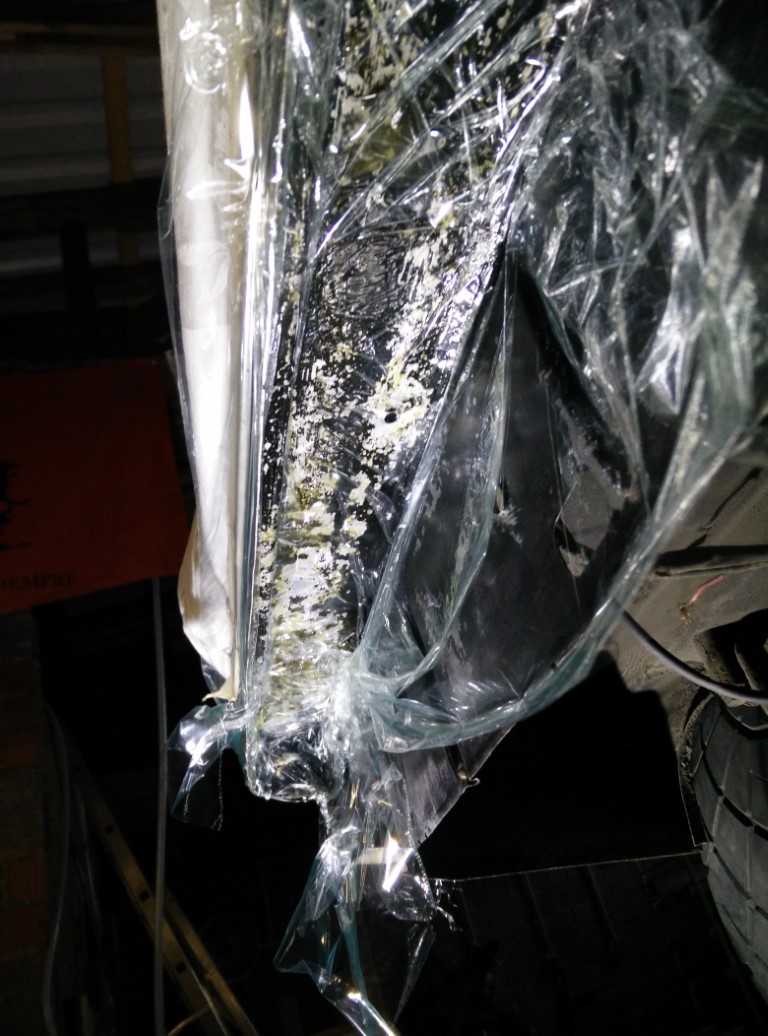

DeOx application with cling film

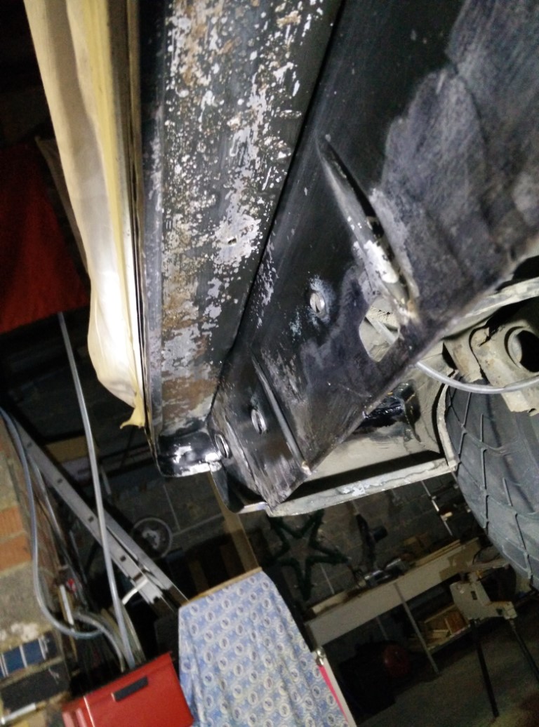

Rusty inside, removed in multiple passes with "DeOx"

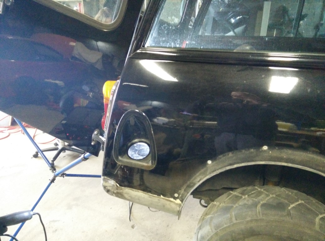

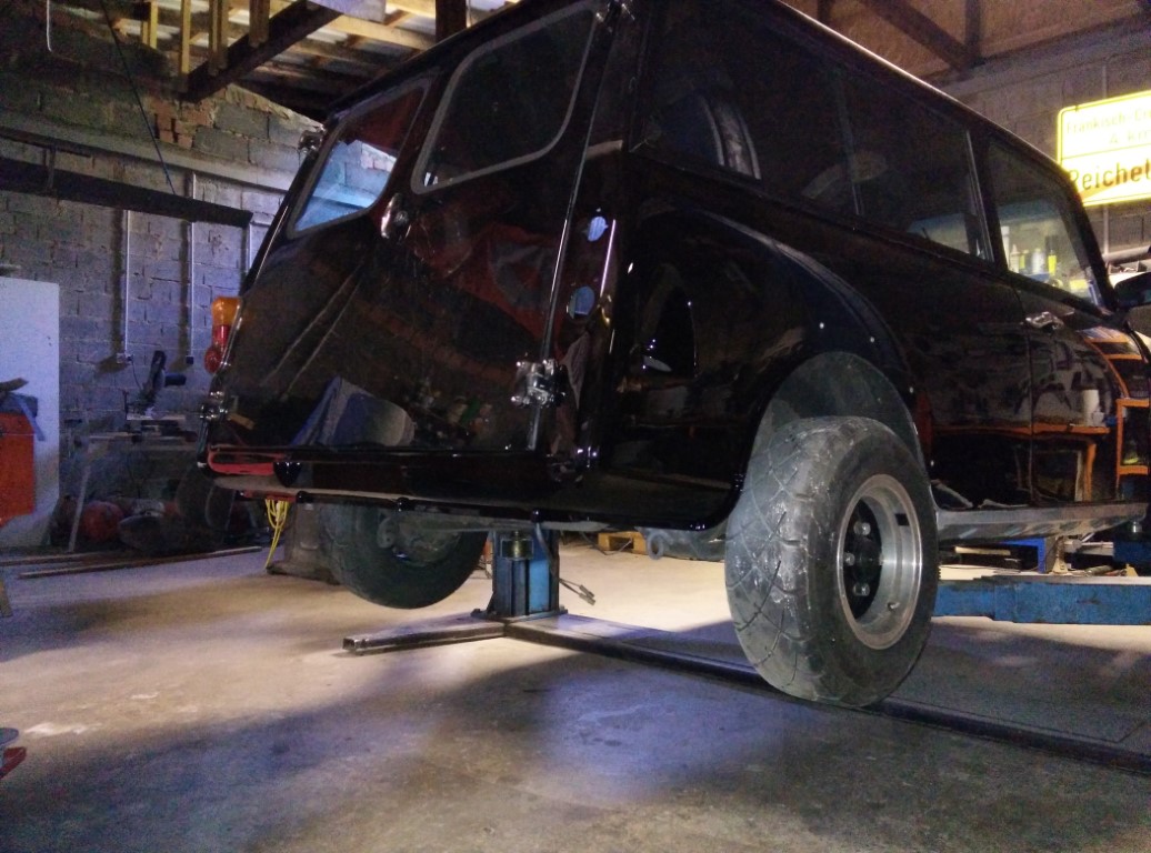

Side view
Side view

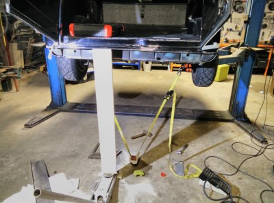

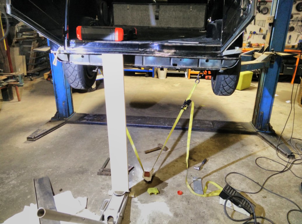

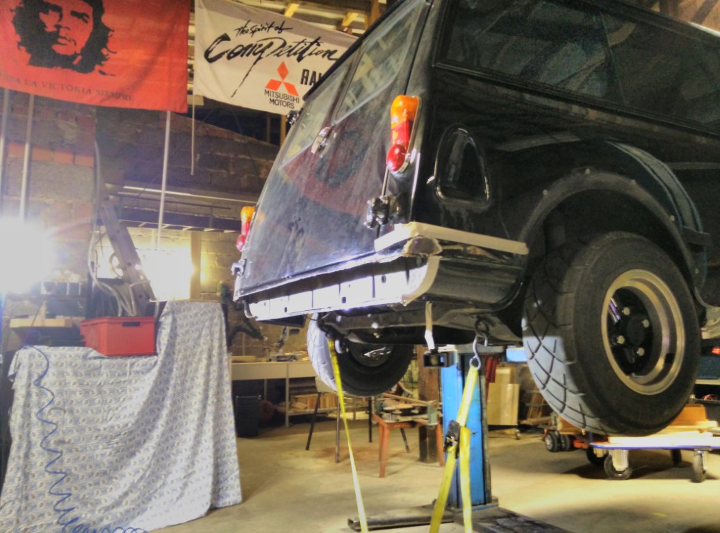

Cut off rear, restrained car to floor, fixed really bad warp by jacking up with wood

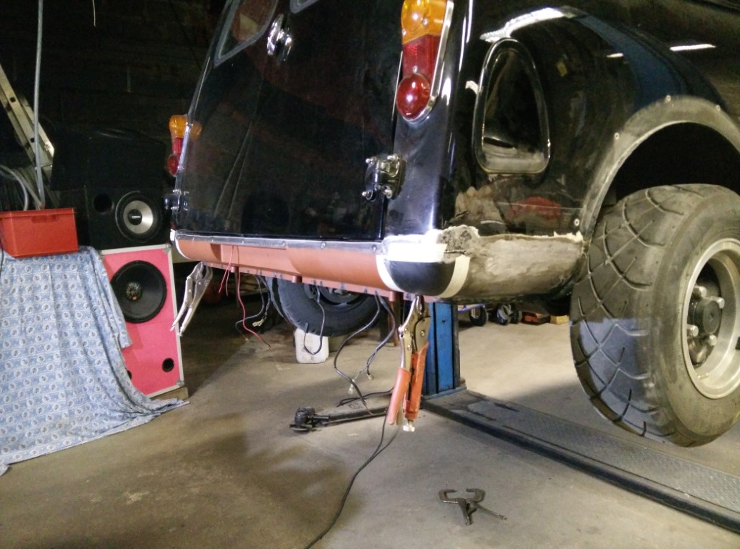

Unfortunately, I don't have pics of all the spot welds and tinning in between. Might be able to snap some from video footage, which hasn't made its way to me yet.
Anyhow, now all those rusty seams and awkward looking parts on the rear are gone and it looks like it should've in the first place. :)
All pieces held in place by tape

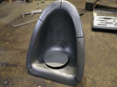

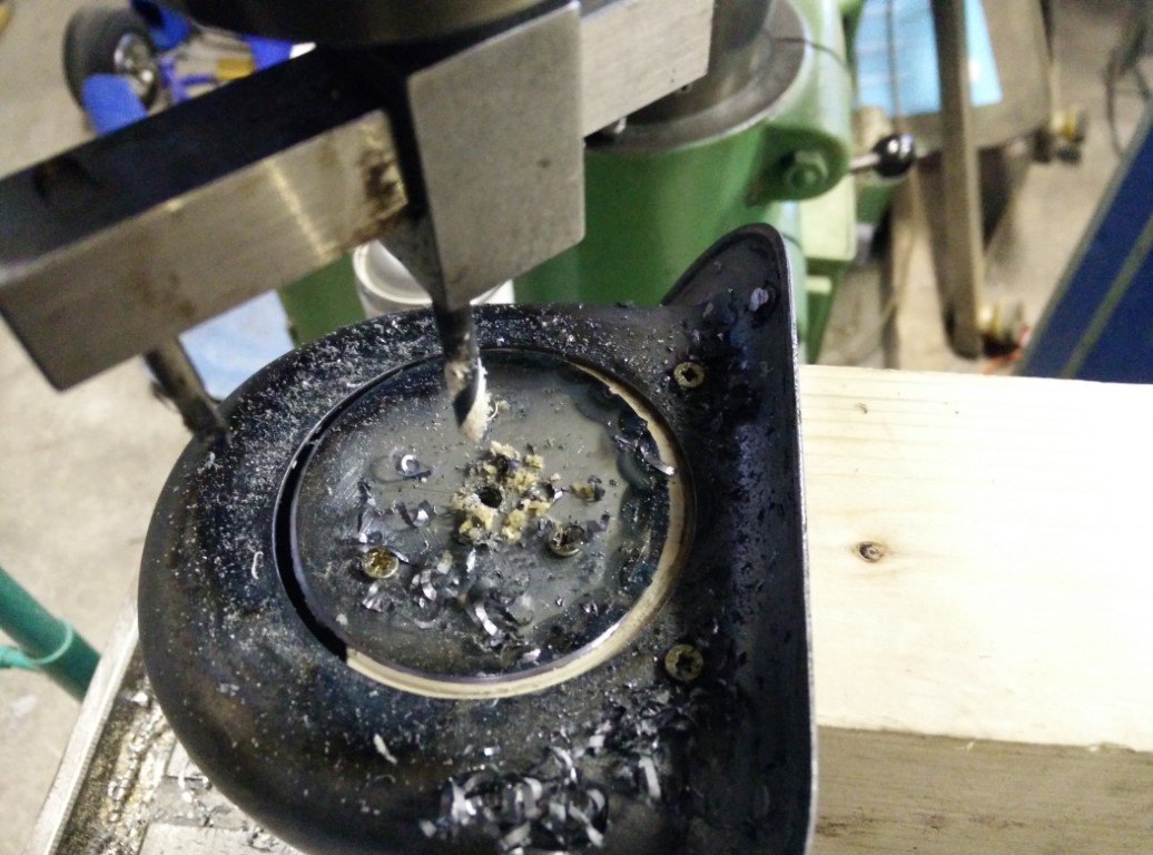

Ugly powder coated tank fill port
That's where it will sit in the future
Close up old tank filler pipe hole
Re-drill new hole so that tank pipe fits again
Fillered
Fillered

3) is that lower rear panel now welded back in? or did you just spray over the tape that was holding it and sand to a fine finish? :-)

2) Those are Yokohama A032, 165/70/10. As you can imagine, I don't drive when it rains. ;)
3) Yeah the center piece is all welded in with little dots about 2 cm apart over the entire horizontal length. Too bad I don't have a picture, hmm. Will try to grab one from video, when I get the files. The other seams I TIG-welded shut with very little amps, always some short distance and varying position, as to not overheat anything. Then everything got smoothed out with tin, then epoxy filler.

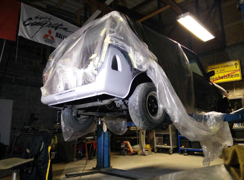

Well, the rear is painted now. I'm happy with the result, although there are some bad runs from the paint. I probably used too fine grit when sanding before. 2500 is not a good idea, when you plan on sticking paint to it. Kinda embarassing, but hey.. The one who doesn't make mistakes, doesn't work at all. :) Will need some more work cutting away the runs and sanding/polishing unwanted dust inclusions, but at least the basic contours turned out very nice.

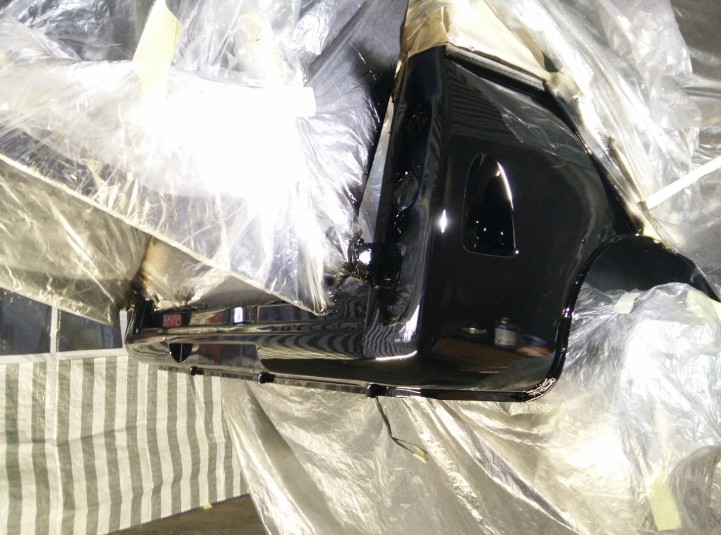

Rear painted and still taped
Rear painted
Rear painted

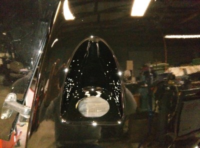

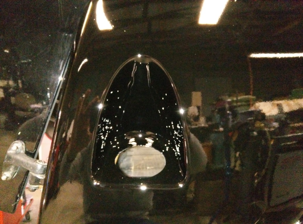

Tank fill port outside, painted

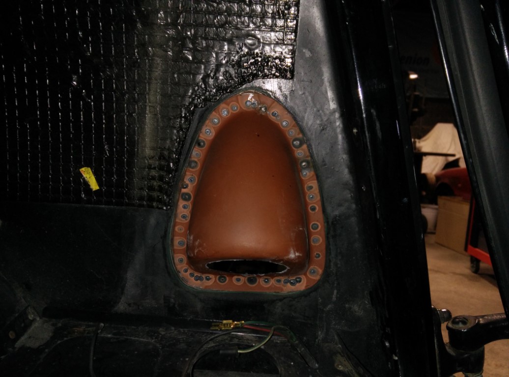

Tank fill port from inside
