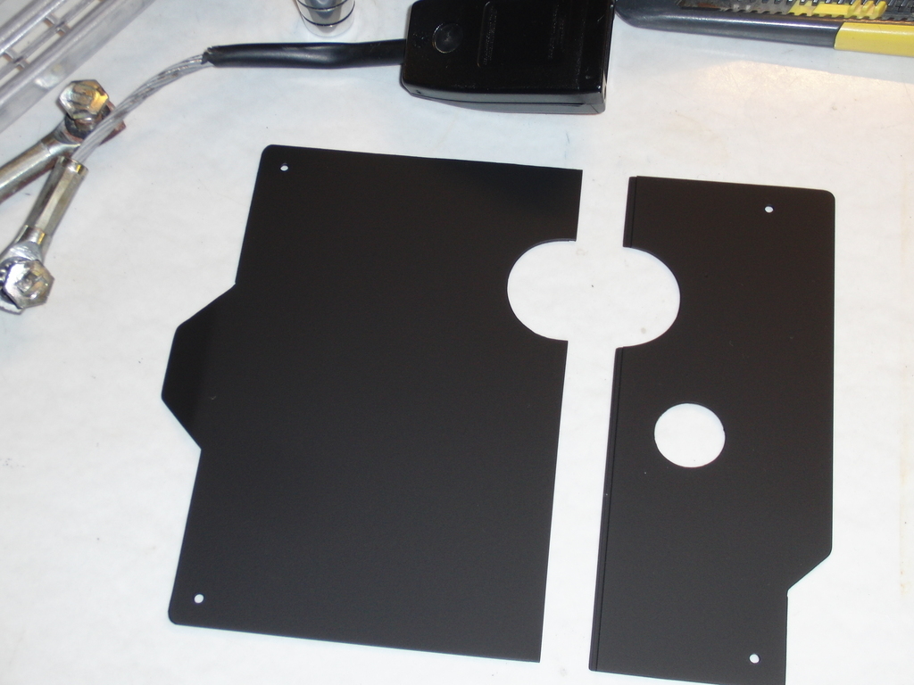

- Painted and re-installed the panel for the large hole in the engine compartment. If anyone wants the DXF or SVG or PDF file of this panel, send me a message. - Cleaned, fixed and oiled the K&N filter. The part that mounts the air filter to the carb had a rough backside, that didn't get the filter housing to seal properly. I put it on the lathe to make it flat at the back and, while at it, polished the air entry. Forgot to take an after-picture and now it's already in... The part itself might be too thin or too bad of material that it bends instead of putting pressure on the stainless plate. - Finished the crank case breather, painted and installed. - Flattened the floor in the foot space area a bit more. Came to the conclusion that in a couple of years, I'll have to replace the floor panels anyways. That made it easier to be satisfied with what I've fixed so far.

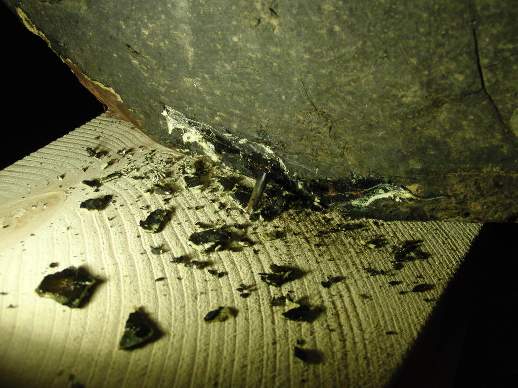

- Filled a rusty seam with linseed oil. Then saw the oil seeping through to the other side a day later. Poked a little and found holes exactly where I put the car on stands, haha. That verified where I'll put the lift points though... - Cleaned and sanded the radiator grille. I've gotten this grille used and it had been painted several colors before. Also, someone tried to clean it with a steel wire brush, which left scratches in the aluminium. It was also bend out of shape a lot, so all in all that grille cost me plenty of hours. It's not available in new, but I'm now happy with what I have. Forgot to take pics, need 3 mm rivets to finish.

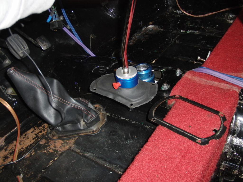

- I was looking at the gear gaiter (odd translation? I'd say "shift sack"

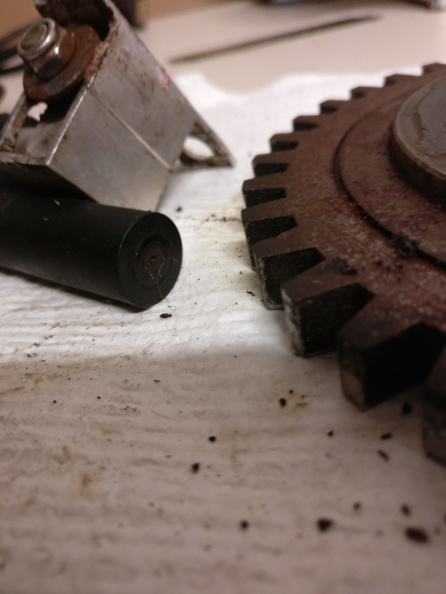

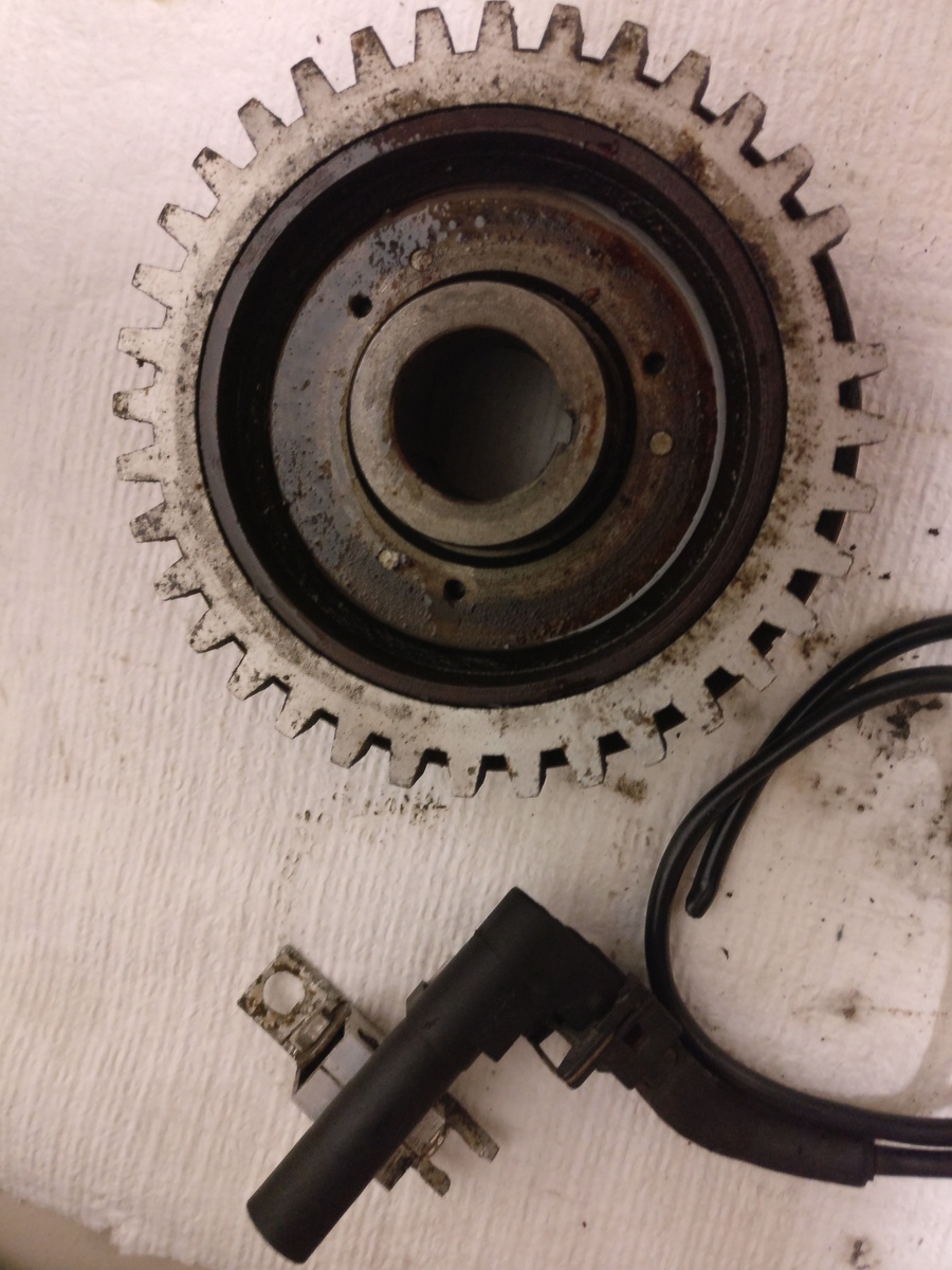

In the meantime, I've received a 36-1 wheel for the crankshaft dampener and a sensor along with it (thanks to forum member KLAS!): Looking at Freds Starlet timing wheel, I'm pretty sure I can make those teeth thinner? The wheel I received has a few scratches and dents that need to be cleaned up on the lathe anyways.
When these parts have found their way onto the engine, we can start talking electronic ignition.

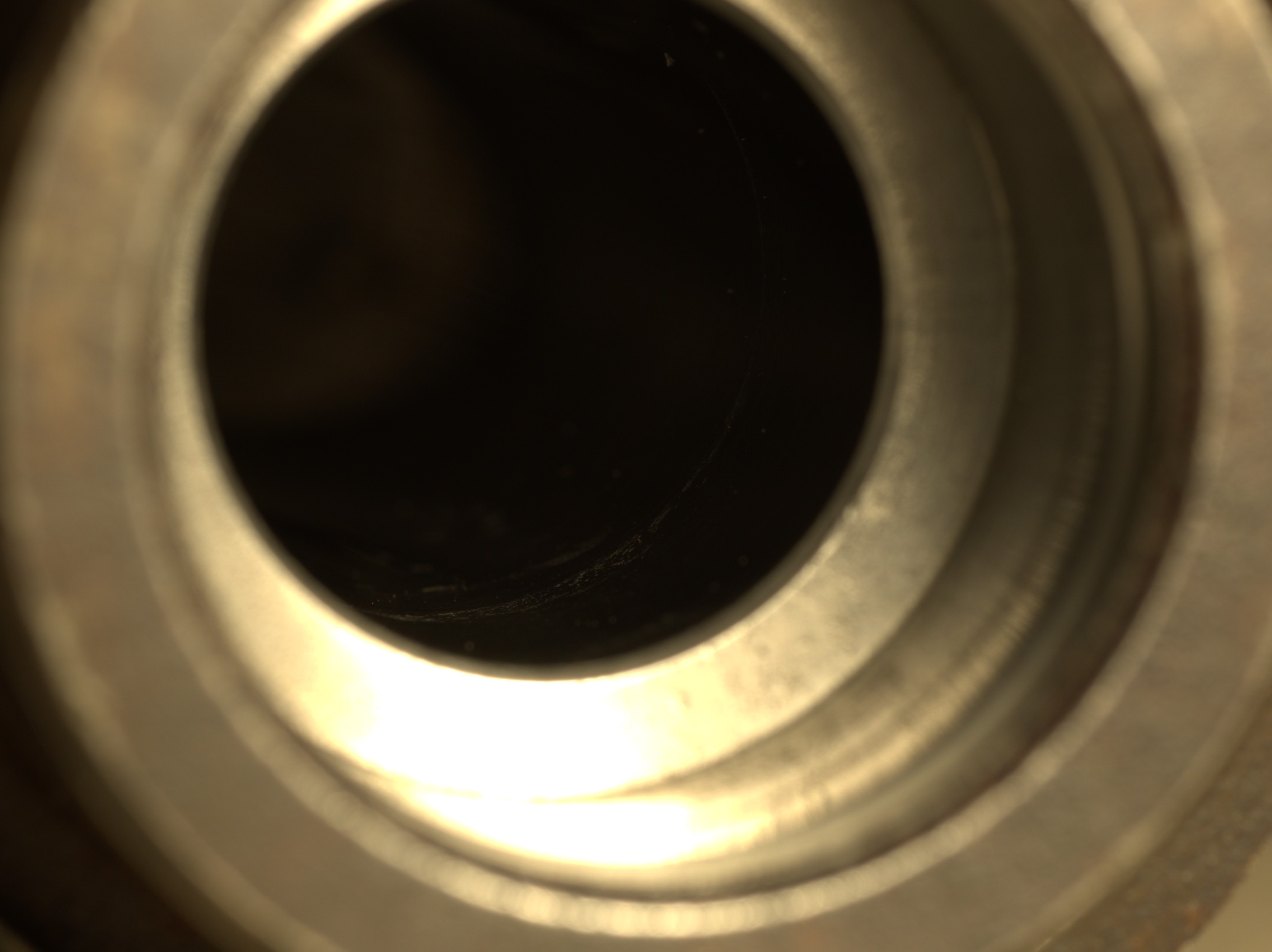

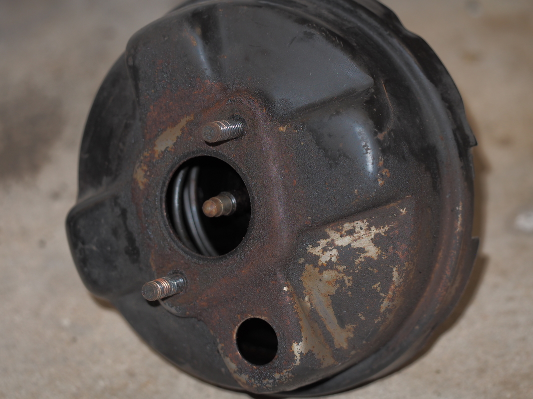

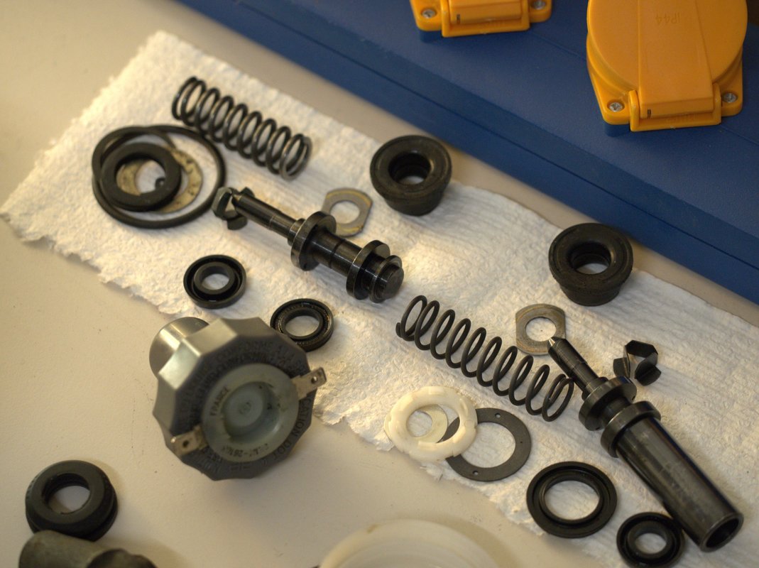

So I disassembled the main brake cylinder and ordered a repair kit (among other things). Unfortunately, there is very slight rust pitting in the bore and I should replace the cylinder, but I won't for now. I'll take my chances.
Brake fluid had been leaking into the servo. So I'll have to clean and paint this thing.
With what kind of liquid should I wash out the servo? Having the old brake fluid stay in there doesn't feel right...
Re: '81 Mini Clubman Estate
Given brake fluid is miscible with water, rinse with hot water, then blow dry with hot air, and store in hot water cupboard for a few weeks? Follow the water with alcohol if you're paranoid about moisture remaining?
As for the pitting, can you get it sleeved? s/s and brass both work well, never wear out, and are fittable to steel cylinders for much longer life in the face of lack of maintenance.
Wow that took me long to understand. I've always had central heating (and hot water piping), but yeah, that's probably a good place to put it.Fred wrote:store in hot water cupboard for a few weeks?
Alcohol seems like a good idea, but I'm concerned about rust in the future when it's all degreased, now that the paint on the inside has been eaten up as well. I suppose a short spray of petroleum wouldn't hurt the membrane?Fred wrote:Follow the water with alcohol if you're paranoid about moisture remaining?
True, steel/brass couple would be nice, but I wouldn't have a tool to hone the brass bore. Hmm. Also, I don't have any more Saturdays to spare for such diversions.Fred wrote:As for the pitting, can you get it sleeved? s/s and brass both work well, never wear out, and are fittable to steel cylinders for much longer life in the face of lack of maintenance.

Re sleeving, I meant to just get it done, but I know the euro car market, how disposable it is, and how fickle specialist services are to find. There is only one or two places in Auckland that do that these days.
Not sure whether alcohol or oil will harm the diaphragm, hence suggesting with a question mark. You'll sort something out, no doubt. Good luck! :-)
