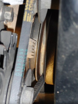

Space-wise, I'd rather have the trigger wheel on the inside of the pulley, replacing the timing disc (picture attached), but couldn't find any ready-made parts yet. KLAS, is there such a part yet?

i don't know any shops for that, as i usually build my own parts. and of cause i put the trigger wheel on the inside, like this

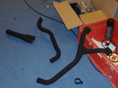

Progress has been made these past days and thought I'd post as Fred does.
- Received some parts
- Derusted the exhaust manifold with "Fertan" and a wire brush under running water; removed the the already defunct O2 sensor nut (-> welded shut by pre-owner) and patched up the hole; then thoroughly heated up the parts with a heat gun; painted them with VHT GS102 heat resistent paint; heated up the parts again (two times) until smoke ceased coming off -> Hopefully burnt in. (Note: Just hand that crap over to sandblasting next time, then paint) - Milled away parts of the intake manifold so that it doesn't collide with the valve cover. Also milled down the screw seats to match the thickness of the header flanges.
- Individually removed between 1.5 and 6.5 mm from the new manifold studs (on a lathe) so they're just as long as need be on the outside and as long as the thread goes into the cylinder head. Now there's no trouble getting on those nuts and all the thread is used. Then fitted all studs with industrial nickel paste "Chesterton 725". Awesome stuff I hadn't known until these days. - Drew up and fabricated a (two-part) closing plate for the huge hole between engine and passenger compartment. The old one (made by pre-owner) was fitted on the engine side, not leaving enough room for the air filter (see groove from scrubbing) and not sealing in various places (=engine smell on the inside). The newly created plates are recessed (milled away ~0.75 mm of 1.5 mm sheet) at their mating edge, so they overlap and seal nicely. Also used the original welded-on nuts, albeit just to stick through some M4 screws. Also, the grommet around the cables is of use now. Once again: Why can't this part be bought?! There must be thousands of odd self-made creations for that hole.
- Built a new bracket that catches both header pipes and latches to the original bracket (at the differential). Also spaces apart the pipes so the Y-piece slips on easily.
- Measured & ordered an exhaust flex piece, ordered O2 bung too.
Next up:
- Wait for flex piece & O2 bung to arrived. Weld those in.
- Remove hole cover from engine bay again, paint black, seal around, re-fit.
- Fit carb again
Later on:
- Replace broken steering boot
Have a nice day!
