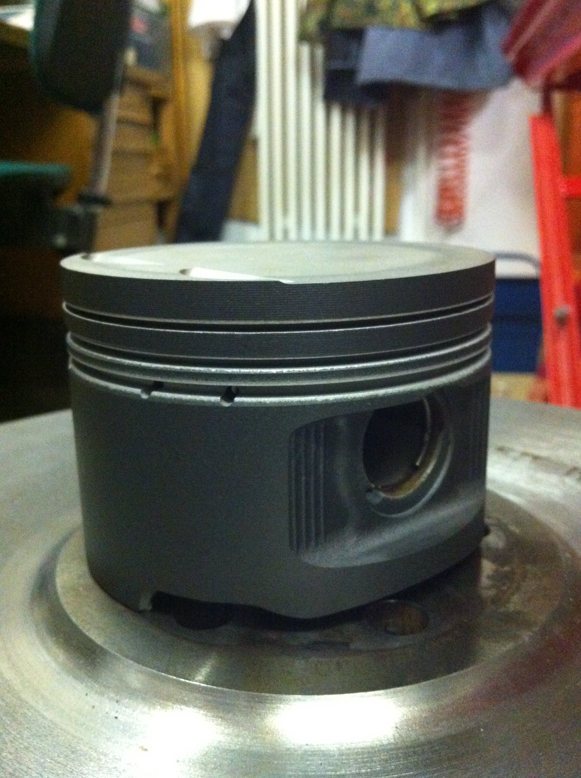

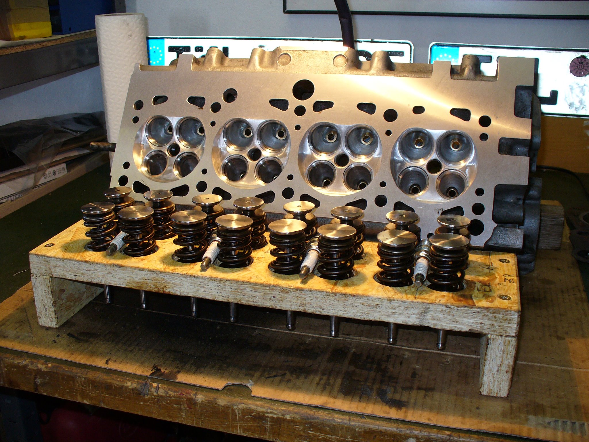

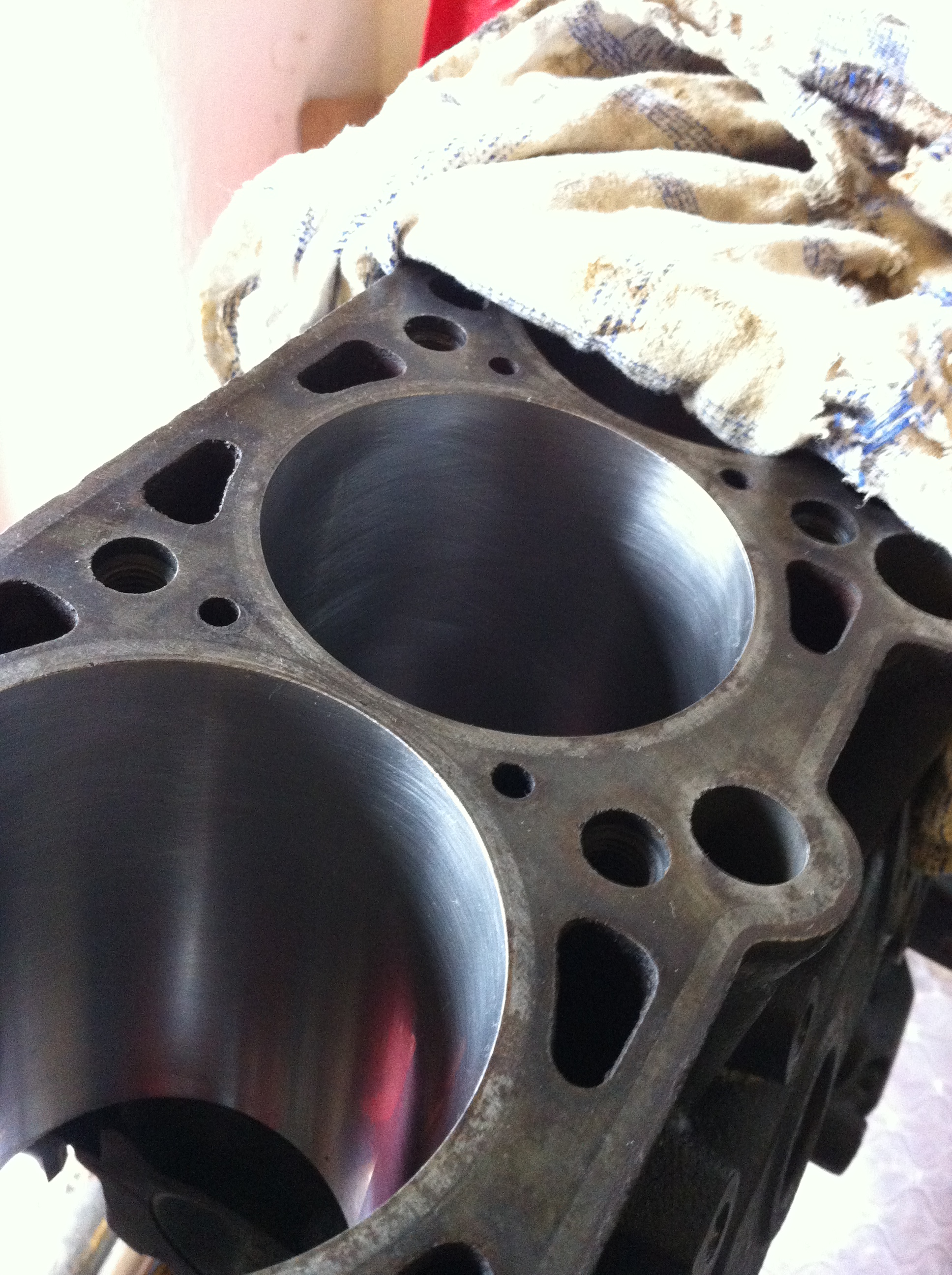

As promised, pics of the engine buid in progress.
We are currently working on the valve cover to fit COPs from the newer VAG FSI engines.
And I did forget to mention, comments are of course very welcome!
edit:

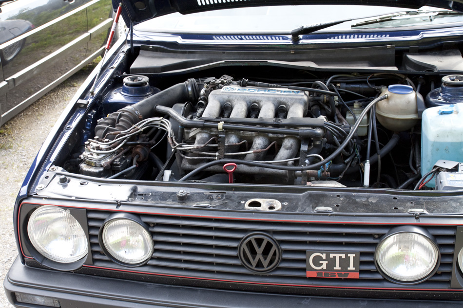

Re: bäda's MKII VW Golf GTI 16V
Very nice car, in the Netherlands nice Mk2 Golfs are starting to become very rare. I quite like the 16V Golfs
I guess it has the 1800cc 16V KR engine
What ECU / trigger wheel setup do these engines use ?
I am planning to install a FreeEMS system on a VW ABF engine (2.0 16V from Golf Mk3), that engine has a 60-2 trigger wheel with hall sensor and a distributor
I think mechanical the KR is very similar, but I think it uses a simpler engine management than the ABF
It's a PL engine which is almost identical to the KR except for slightly different camshaft timings and an enhanced engine management with lambda control and knock sensing.
But it is far from the modern engine management the ABF uses. If I've had the choice I'd also gone withe an ABF, just the 60-2 trigger on the crankshaft on it's own is good reason, but they're quite expensive compared to the 1.8 and old 2.0 (9A) 16V engines, which you can get really cheap.
Originally these engines use a distributor with a hall sensor, but as you can imagine we're not planning to use this setup. As already mentioned we are currently trying to fit COPs from the FSI engines and for rpm and position sensing we will try a crankshaft seal flange with integrated 60-2 trigger wheel from some newer engine which is almost a perfect fit.
