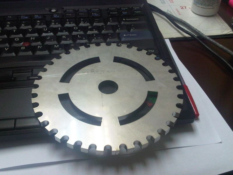

1 Crank RPM/Position VR input connect directly to ECU, with crank mounted Ford type 36-1 teeth wheel.
