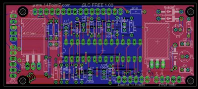

The magazine will not publish my design, I will still move ahead and release my design as an open source project and publish it on my website.
I have laid out a new PCB which will support a 2x16 LCD display.

Re: My open source Wideband Controller, SLC Free
nice work
and really nice idea to add support LCD 2x16

Thanks for the offer Fred, I would rather not publish it on an automotive magazine, I wanted an electronics magazine because they can call BS on my design and keep me honest. In a automotive magazine I can put up all sorts of claims and not be called out for it. I still have some options for publication by an electronics magazine but I am just concentrating on finishing up the project first.

I am not an electronic designer by any means, but a cool addiction would be support to higher afr, so the diesel guys can use this
I watch his videos from time to time, he knows his stuff. I will send him an email and see if he has interest in automotive performance, if he does then I will send him a unit and have him tear me a new butthole.Fred wrote:Fair enough, I guess. I thought you were just looking for exposure. That's an admirable attitude

The issue with supporting a higher range of AFRs is that it will dramatically increase the flash space required. Right now for 0.68 to 1.36 lambda, there is a lookup table with about 400 entries to map pump current to lambda, each entry is 2 bytes wide, so right now 800 of the 4k bytes available are tied up with the lookup table and that is just for 0.68 to 1.36 lambda.masterkorp wrote:I am not an electronic designer by any means, but a cool addiction would be support to higher afr, so the diesel guys can use this
I suppose if you are ok with reduced resolution that you could somehow fit in a large lambda range, but that is something for someone else to do if they want it.

I'm curious as to why you must use a lookup table as opposed to a mathematical approach? Perhaps the speed benefit of not having to do maths is what it comes down to?
Regardless, nice job. This is really good to see. How does this design differ in concept to your other WB designs?
