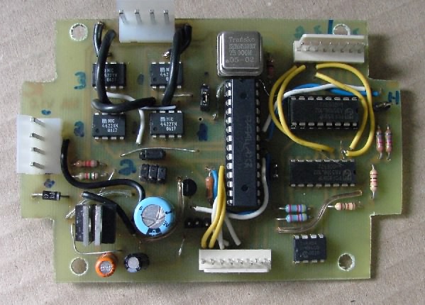

About a year ago i decided to build a fuel injection system for my gokart engine. The carb on the engine was really flaky and i had rebuilt it several times with out much luck. i did some research and this is basically what i came up with. the engine for the project is a 840 cc twin.
I used the SX-28 microcontroller from parallax. the sx series are pretty fast. run on instruction per clock and i have my running at 75 Mhz with is over kill but thats ok. its only 8 bit. but with the extra processing speed i do 16bit in software. i ordered a bunch of parts all at once then started playing around and learning how to program the microcontroller.
i used a MPX4250A for my map sensor,
two MLX90217 hall effect sensors. one on the cam and one on the crank.
two generic temperature sensors
and cheep o2 sensor and i used a potentiometer connected to a throttle body for my tps sensor.
then i picked up the cheapest fuel pump, injectors and pressure regulator i could find. i used ones from a ford escort.
i thought about using data tables and maps but decided just to do some testing then developed my own equations for VE, and pulse width. with doing all the calculations in real time and reading all the sensors every revolution, and using un-optimized code, the little sx microcontroller can handle just above 12,000 rpm. but considering my engine is only suppose to rev to 3600 but i take it to 4500 rmp, 75 MHz is excessive.
first ill describe the pcb then the software.
this was the first pcb i etched, i used an laserjet printer and some magazine paper and after a few tries i was able to iron on a good outline onto the copper. then etched it with ferric chloride and mounded the components as seen in the picture above. I have 4 mosfet drivers. (i accidentally ordered mosfet drivers instead of mosfets but they seem to work for the injectors fine. ) two are for the injectors and the other two along with a set of ignition mosfets are for the ignition coils. i havent installed the electronic ignition yet as i havent had time but its just a matter of connecting up two wires and disconnecting the old point system. anyways the chip in the middle of the pcb is the microcontroller, then i have 2x 8bit 4 channel ADC's and 4KB of eeprom. and a transistor driver for serial communications, sending engine data to a computer program i wrote. fairly strait forward just connecting the correct pins and adding pullups were necessary, should really have some more decoupling caps on there but the noise on the electrical system is minimum. i have lots of unused inputs/outputs that i might connect to relays to turn on and of the fuel pump and other systems.

'if idx3 > 495 then ' wait for end
if twov(2) < 155 then 'enging warm enuf
if fivev(2) > 140 then ' throttle closed
if twov(3) > 70 then ' runnin rich make leaner
ox = ox - 1
endif
if twov(3) < 40 then ' running lean make richer
ox = ox + 1
endif
ENDIF
ENDIF
endif
ve = ve * ox
ve = ve / 100
'endif
endif
' IF twov(3) < 45 THEN 'running lean make richer
'if rb.3 = 1 THEN
' ox = ox + 1
've = ve * ox
've = ve / 100
'ENDIF
' high rb.1
' ENDIF'
'ELSE
' if twov(3) > 75 THEN 'running rich make leaner
' high rb.0
' ENDIF
' high rb.1
' ENDIF
'ENDIF
'----------------------TPS sensor enriching
tpsinc = 0
if tpsold > fivev(2) THEN
tpsinc = tpsold - fivev(2)
if fivev(2) > 155 THEN
tpsinc = tpsinc * 24' 25
ELSE
tpsinc = tpsinc * 6 '5
ENDIF ' accerloatior enrich
ENDIF
tpsold = fivev(2)
'---------------------- low rpm idle increase to prevent stall( Expermental, not sure if i want to keep this or not)
if idx3 > 10 THEN '10 '45
if rpm > 120 THEN
tpsinc = tpsinc + 10
ENDIF
ENDIF
'----------------------calculate fuel
temp = 243 * fivev(1) 'map sensor
temp2 = 514 - twov(1) 'temp sensor
temp = temp / temp2
temp = temp * 237 '237
temp2 = temp / 50
temp2 = temp2 * ve
temp2 = temp2 / ratio ' ratio
temp2 = temp2 + tpsinc
temp2 = temp2 + 25 ' injector open time 25 on 4, 100 on 1
pulsout ra.1, temp2, 4 ' left side of engine
'-------------------- second cyclnder
temp2 = temp / 49
temp2 = temp2 * ve
pulsout ra.0, temp2, 4 'right side of engine
'ENDIF
endif
ENDIF
'watch temp
'watch ve
'watch fivev(0)
'watch fivev(1)
'watch fivev(2)
'watch fivev(3)
'watch twov(0)
'watch twov(1)
'watch twov(2)
'watch twov(3)
'break
GOTO Main

Re: MarkIsTuff's DIY EFI controller
Thanks for posting that up Mark, very interesting :-)
So the equations you used to represent your VE curve are bespoke to your engine correct?
Admin.
Admin.
markistuff
- TO220 - Visibile
- Posts: 4
- Joined: Sat Mar 01, 2008 8:09 pm
Thats correct.
it all depends on how the intake is designed, valve layout ect. what i did was i had the engine at almost no load, then went through the rpm range, then a full load through the rpms recording the VE setting that would make the engine run good. i downloaded a graphing program that i could graph the two curves. then i did some algerbra and stuck them into one equation. when graphed looks 3d like when you graph a map lookup table, but it should have every posable value instead of defined lookup spots. i did get a wideband O2 sensor had was in the process of building a controller for it to propory tune my engine but i havent gotten around to finishing it yet.
when i first setup the efi i didnt know about VE so the engine ran really really rich. then underload it leaned right out and would backfire like crazy. but after a few revisions of the program code and learning about VE those problems were gone. i should really change the youtube video, that was one of the first test programs i wrote for it, still running from a prototype board and wires everywere.
Firstly, don't change it, just add more :-)
Secondly, in your opinion, would it be possible to use a Fourier style equation to generate a tunable curve for general use with one code base? (Or similar) I suspect it would be A difficult to do, B difficult to tune, C expensive computation wise for a generic solution.
That's a nice project doing it that way :-) Very impressive!
I look forward to your updated videos :-)
Admin.
Admin.
thebigmacd
- Posts: 205
- Joined: Thu Apr 10, 2008 5:51 pm
Great stuff going on in here!
I currently have two of the aforementioned Propeller chips sitting on my workbench undergoing setup to drive a servo-controlled custom gauge cluster.
Now that I have gotten into it, the power of the Propeller has become very evident to me. I would suggest trying it out, Mark. I am personally very tempted to design a Propeller-based ems system myself. The only caveat is the Spin high-level interpreted language is 1/10th the speed of the equivalent assembly, so it would have to be mostly in assembly. The nice thing is assembly and Spin can be mixed as long as they are on separate cogs.
Here's an example of the power of the Propeller: the built-in "Servo32v3" object runs in a single cog...it can control all 32 i/o pins as servo pwm outputs to the nearest microsecond, all with individual pulse widths. That leaves the other 7 cogs running at full speed to do whatever I need them to do, concurrently.
PS I like that Fourier concept Fred.
Keith MacDonald
Control Engineering (Systems) Technologist
