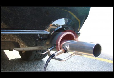

Innovate has one that seems extreme, but might be the minimum required:
http://stuff.fredcooke.com/innovate-clamp-highres.jpg
FAST have one that seems insufficient:
http://www.fuelairspark.com/fas/ez-clam ... t-kithtml/
http://www.jegs.com/p/FAST/FAST-EZ-Clam ... 8/10002/-1
My thoughts? Innovate's one puts the sensor in quite a laggy spot. But perhaps that's to guard against water droplets having a direct path to the ceramic element? Optional rubber cap for the screw clamp would be nice. Lower diameter is better than higher, and something bigger will allow a higher air speed through the centre past the sensor. Maybe 25mm or 30mm ID or something like that for optimal sensor-pipe geometry? But if you want to dump it out up stream rather than down stream, 2 times 25mm is getting pretty big. Not much more to say right now.
