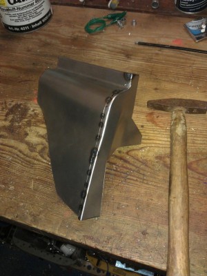

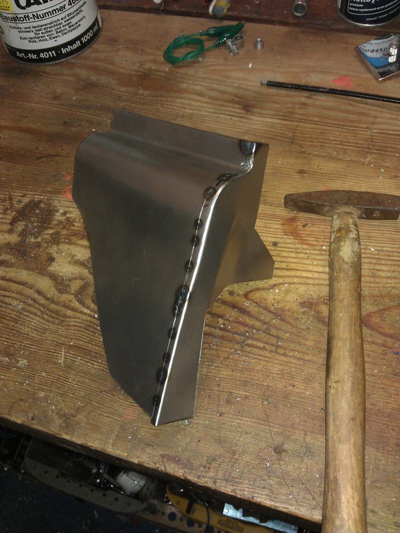

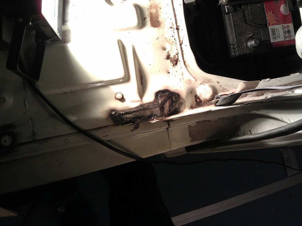

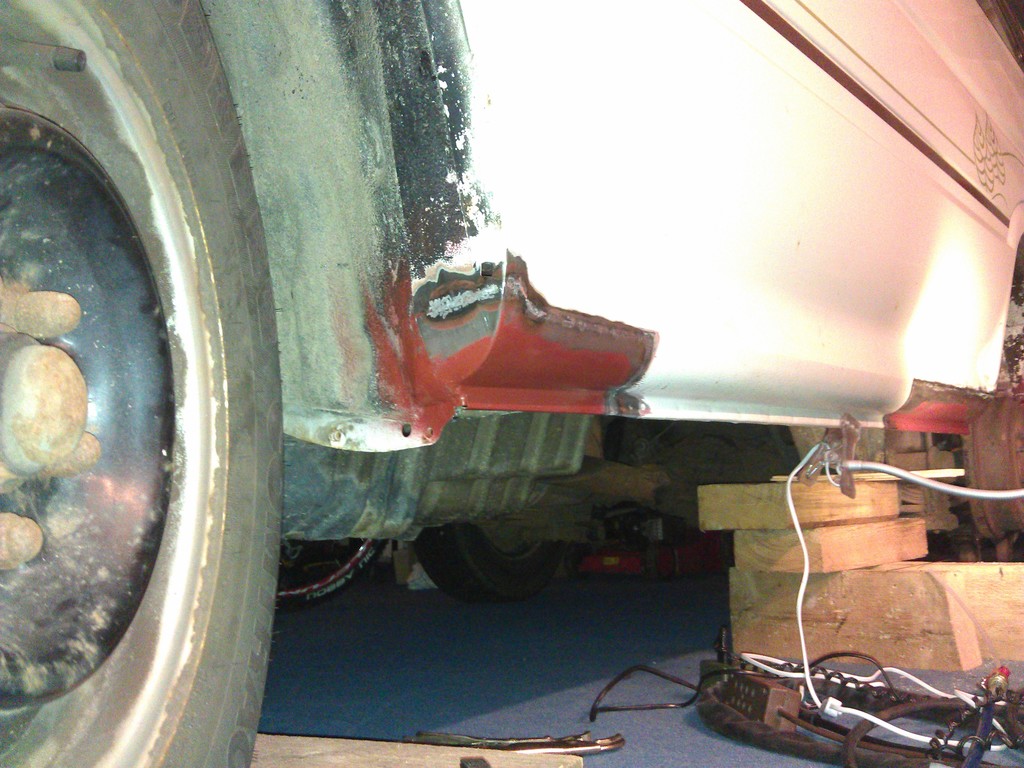

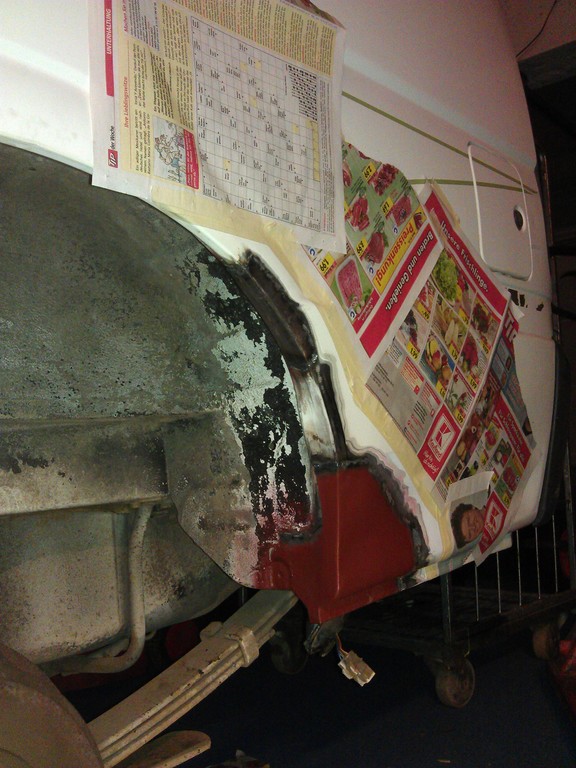

I've repaired all rust on the left side. Took me 13 pieces of sheet metal, about 8 litres of argon and quite some nerves hammering it all in place. I'm pleased with the result, as I've never mangled sheet metal this way before, nor TIG welded in such awkward positions (welding to rusty metal, without foot pedal, is quite challenging). The welds that are hidden, shouldn't be looked at anyways, the outside welds turned out just fine. ;)
File comment: Middle pieces in place, parts of both inside and outside panels were replaced.
File comment: Piece for rear left.
File comment: First weld repair, under driver's seat. Very rusty around, kept burning away.

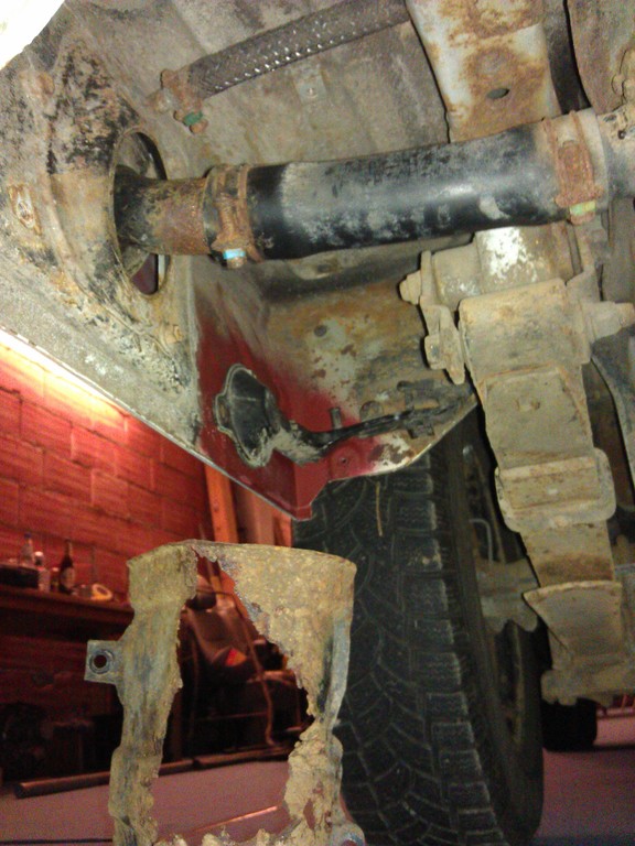

Some more parts pictures.. Yes, it was a PITA.

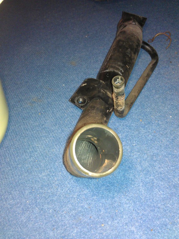

On another note: While crawling around under the car, I removed the protecting shield for the fuel tank inlet hose. The trapped mud in there smelled of fuel, because the filler pipe is really rusted out. After driving around yesterday, fuel that has sloshed around in the tank was dripping from the pipe.
So THAT's where the high fuel consumption comes from.... maybe a little, the mud might have sealed it some, lol. :/
Today I removed the pipe and will weld in a new piece, without holes in it.
Also, I discovered a leaking heater pipe with similar damage, rust where hose is fitted over pipe. The whole pipe is rusted, need to figure that one out too..
File comment: Fuel pipe. Rust points on the inside have tiny holes.
File comment: Rear left from inside. Tank pipe with rust holes, formerly mud filled "protector" lying beneath.
File comment: Rear left.
