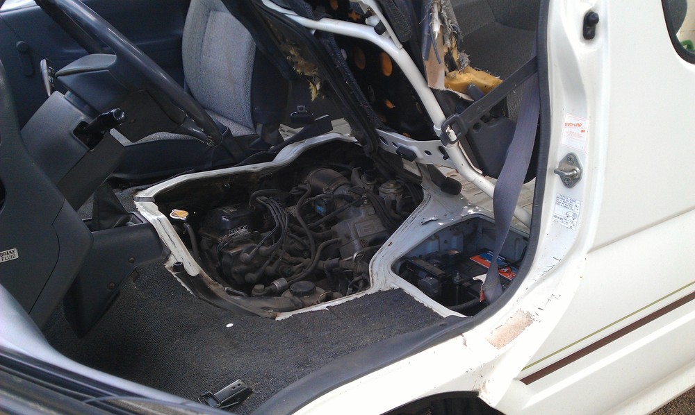

It's a Toyota Hi-Ace from 1991, originally a 9-seater, nowadays pure transporter. (see pic3)

  • Knocking sound in idle
    When in idle (<900rpm), there's a mechanical sound from the engine. Sounds like a rod bearing, so I suspect low oil pressure. When the engine's reving a little higher (>1000rpm), the noise goes away completely.
    What to check first? Where can I attach a pressure gauge? The engine bay is not so spacious (see pic1), I'd rather know beforehand where to look... :)

Other than being in sad condition, it looks very standard. I forget the connector pins to bridge, but I bet you can. It's likely googleable too. http://pinouts.ru/CarElectronics/toyota ... nout.shtml just for example, from a quick search. I bet you can do better. My terms were: http://duckduckgo.com/?q=toyota+diagnos ... t&kl=wt-wt

Why is this not number one? It could be HLAs if it uses them, I'm unsure what it has, though. If it's rod knock, it's not going to be around for long if you're still driving it. Dip the oil, and put the stick in sunlight, it will shine with ultra fine glitter if you have a bearing on the way out. If it's not using HLAs, it could need its lifters adjusting.

Because I still have hope it's not a rod bearing ;) Good idea to check the oil for glitter.. didn't see much (now at 10pm), but oil on the rag I used to wipe the oil dip stick with had some glitter in there. Crap. Will check again tomorrow, hopefully I'm haluscinating right now. If not, yes, this should be #1.

EDIT: Oh and I forgot: I don't think the connector is in bad condition, it's just the factory protective grease because it's never been used :)
