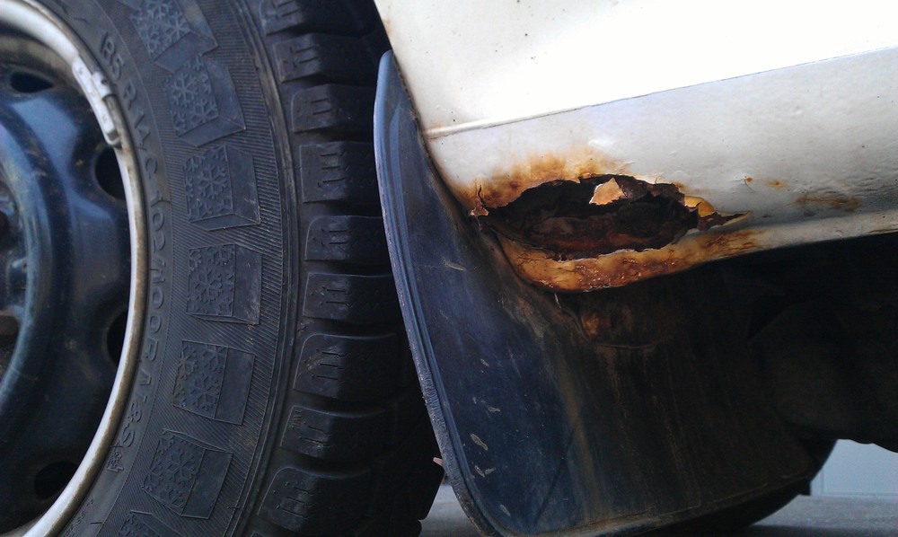

- Also discovered some rust that needs taking care of
