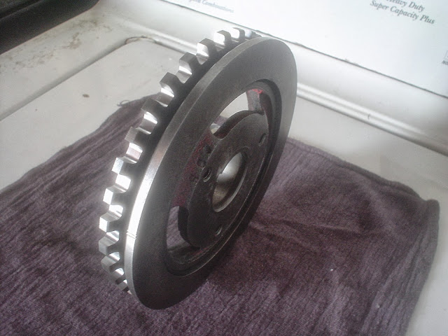

Another hurdle passed, I got my trigger wheel made. I was unhappy with my first hack job on a pulley that turned out to be not so round and not so true so I went back to OEM engineering and just milled some .250" teeth into the back of my balancer. Its true, round and thick enough to trigger the sensor, and it was free! (well, if you count a buddy that has access to a $xM aerospace 5 axis CNC mill). Might be easy on any mill but setup time and know how is beyond me. Will work fine. Yeah, its on the rubber isolated ring, but this timing hasnt changed in 53 years.....just need to tack weld mount into position and clean/paint. Belt goes right around it. Will grind missing tooth once I know exactly which one will go.
Re: Choosing a crank trigger/wheel
Looks nice! Is it missing tooth? If so, can we see that bit?
Yeah, its not the best option, but its what Im going to attempt. The missing tooth is TBD. I have to mount it and find where the tooth will sit , then Ill grind it down {against all you told me ;-(} so as to not trip the VR sensor. If it gets crazy unstable, ill burn out the rubber, and mount the ring rigidly to the hub behind another balancer. I got a few. What if I just make it rigid as it sits, ie. tack weld the ring over the rubber to the hub? Slant six is butter smooth anyway, I doubt Im going to break a crank with harmonics at 3500 RPM and 200 hp......Im not going to spin it faster than 5500. We'll see. I just didnt like the way the off the shelf wheels stuck out as I have limited space up there.
All fair, just wanted to make you more aware, that's all.
