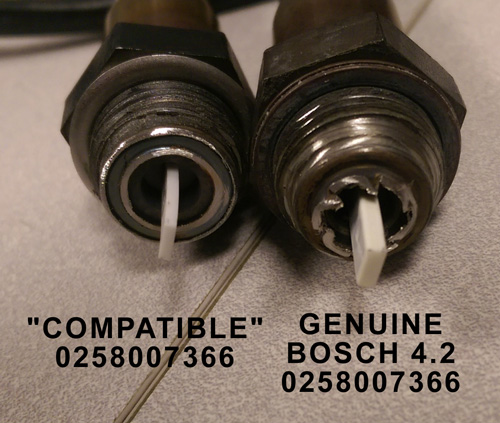

The sensor itself looks reasonable and might pass for a wideband Bosch sensor if you were not familiar with them. The sensor does not say Bosch on it, so it is not a “knock-off” but it does have “0 258 007 366” etched on it.

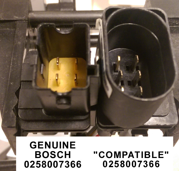

1. It has the wrong style connector on it. It specifically calls itself a “0 258 007 366” which is a Bosch P/N for a LSU 4.2 with the square connector. The connector on this one is the larger oval connector that comes on some 4.2’s as well. So it’s configured incorrectly right out of the gate. The connector is also a copy, not a genuine Bosch connector, but at least it does plug into the oval 4.2 connector mate.

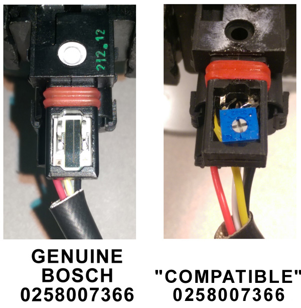

2. Trim Resistor. I was pretty surprised that it had the trim resistor built into the connector and figured that this could bode well for this sensor. A company that was doing this must be a step above their counterparts, right? Wrong.
I just about choked on my cheerios when I pried the cap off the trim resistor cover. I should have known when I realized the cover was glued on that what was underneath was something I was not supposed to see. But I didn’t expect a trim pot, hand soldered in place. Not exactly the laser trimmed resistor in the Bosch unit. So much for “Manufactured to meet or exceed OEM Specifications”.

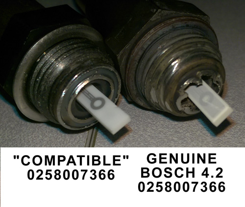

3. Sensing Element. I cut the protection tubes off the unit, really not having any idea what I was going to find. I was surprised (pleasantly?) to find an actual ceramic planar element. It is physically different size and shape than the genuine Bosch 4.2 (and it’s slightly curved) but at least it appears to be using the same or similar technology.
Genuine cell dimensions (1.8mm thick, 4.4mm wide, 17mm long), Ceramic volume 135mm^3
“Compatible” cell dimensions (1.1mm thick, 4.2mm wide, 15mm long), Ceramic volume 69mm^3
The different ceramic properties probably means that the heating response will be different between the units and a heater PID tuned for one will not be optimal for the other.
Measured heater resistance at room temp;
Genuine sensor heater resistance at room temp = 3.0 Ohms
“Compatible” sensor heater resistance at room temp = 3.8 Ohms
So the current on the heater will be less, but that may be a good thing since the thermal mass of the element will be less as well. Actually, the element on the “compatible” appears to be more closely related to a 4.9 than a 4.2. But if your system expects a 4.2 then giving it the heater properties of a 4.9 may cause some issues.
